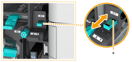

* Slide the guide in or out to align the nearest
with the mark ( ). |

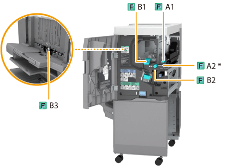

Remove the jammed paper.
Close the guide (F-A2).
Close the guide (F-B1).

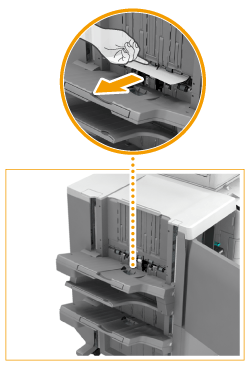

Open the guide (F-B3).
Close the guide (F-B3).
