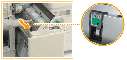

      3
      Pull the lever on the two staple cases toward you to remove them.
