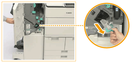

      Open the front cover of the finisher.
      2
      Pull out the staple case from the stapler unit.
      Hold the green tab of the staple case, and pull it out straight toward you.
      3
      Remove the empty staple cartridge from the staple case.
      4
      Take out a new staple cartridge from the box.
      5
      Insert the new staple cartridge.
      6
      Hold the green tab, and push the staple case back into the stapler unit until it is securely in place.
      7
      Close the front cover of the finisher.
