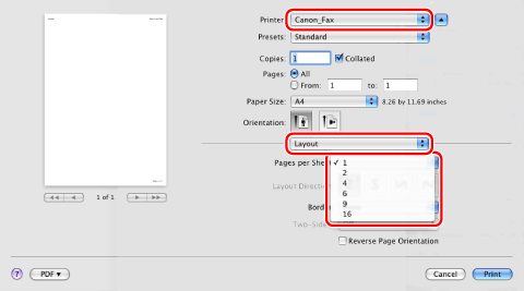

Multiple pages of the original can be output on one sheet of paper by reducing the print size.
1.
Select [Print] from the [File] menu of the application.
2.
Select your fax → [Layout] → the number of pages you want to output onto one sheet of paper from [Pages per Sheet].
3.
Select the page order from [Layout Direction].
4.
If you want to add a border to each page, select the line type from [Border].
5.
Click [Print].
The fax is sent with the specified layout.
If you select a cover sheet when sending, the layout is not applied to the cover sheet. The layout is only applied to the pages you are sending.
