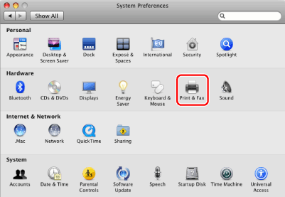

1.
Open [System Preferences] → click [Print & Fax].
2.

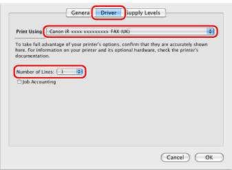

Select the fax you are using → click [Options & Supplies].
3.
Click [Driver] → confirm that your fax is selected for [Print Using] → configure the options installed in the fax.
IMPORTANT
Be sure to select only those options that are actually installed in the fax.
4.
Click [OK].
