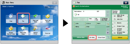

1.
Press [Fax] → [On-Hook].
2.
Enter the recipient's fax number using - (numeric keys) → when your call is answered and you hear the recorded message of the fax information service, press [Tone].
To use a one-touch button, press [One-Touch] → select the desired one-touch button.
If you know the three digit number for the one-touch button, you can press  → enter the number of the desired one-touch button using - (numeric keys).
If you are already using this machine with tone dialing, this step is not necessary.
