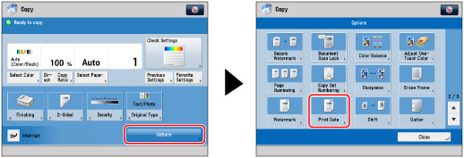

1.
Press [Copy].
2.
Press [Options] → [Print Date].
3.
