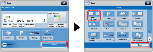

1.
Press [Copy].
2.
Press [Options] → [Book 2 Pages] → [Close].
