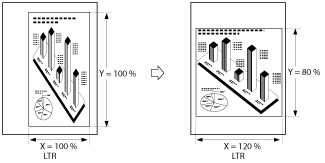

The XY Ratio mode enables you to specify different XY copy ratios in percentages to make enlarged or reduced copies. You can set a copy (zoom) ratio from 25% to 400%.
Manually Specifying the Copy Ratio (XY Ratio)
You can manually set different copy (zoom) ratios for the horizontal (X) and vertical (Y) axes, expressed in 1% increments.
Automatically Specifying the Copy Ratio (Auto XY Ratio)
The XY copy ratio is automatically set to suit the size of the selected paper.

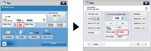

If LTRR is selected:
1.
Press [Copy].
2.
Press [Copy Ratio] → [XY Ratio].
3.
Press [X] and [Y] → press [-] or [+] to specify each copy ratio.
You can also use the numeric keys to enter values.

4.
Press [OK].
