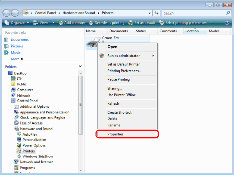

2.
Right-click the icon of the fax whose settings you want to configure → click [Properties] (or [Printer properties]).

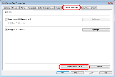

3.
Click [Device Settings] → [Get Device Status].
The driver settings are configured according to the option information obtained from the machine.
4.
Confirm the settings such as the fax board → click [OK].
If you are using a shared printer, you need to install Canon Driver Information Assist Service in the print server computer in order to use the [Get Device Status] function. For details about how to install the Canon Driver Information Assist Service, see the "Fax Driver Installation Guide" (see "Installation").
If the information request returns an error message, you need to manually select and configure such settings as optional fax board, memory, etc. installed in the fax you are using.
If the fax and computer are connected via USB or a WSD (Web Services on Devices) port, the [Get Device Status] function is unavailable. You need to configure the settings manually.
