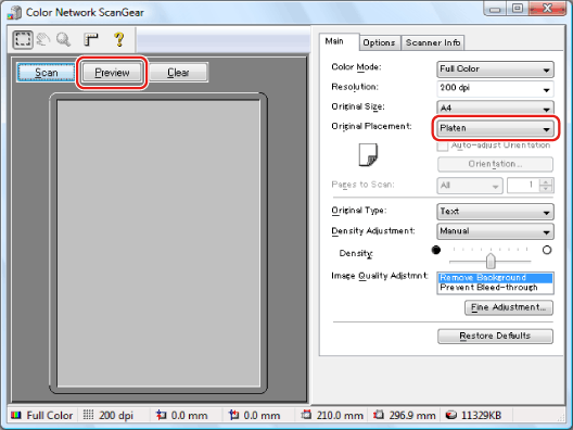

Switch the scanner online → place your originals face down on the platen glass → start Color Network ScanGear or Network ScanGear from the application.
For details, see "Scanning from the Platen Glass."
2.
Select [Platen] for [Original Placement] → click [Preview].
