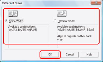

Select [Different Sizes] from [Original Size].
3.
Select the appropriate combination of original sizes → click [OK].
For sizes such as A3 and A4, where the longer side of the smaller original is the same size as the shorter side of the larger original, select [Same Width].
For combinations of sizes such as A3 and B4 with no sides of the same length in common, select [Different Width].
If a non-standard size original is included, you cannot use [Different Sizes].
When scanning a non-standard size original, select [Free Size] or [Custom] from [Original Size].
You can only simultaneously scan originals whose width or length are the same.
