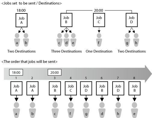

If multiple fax jobs reach their delayed send time simultaneously, documents are sent in the order indicated in the illustration below.

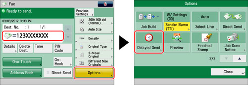

1.
Press [Fax].
2.
Specify the destination → press [Options] → [Delayed Send].
3.
Enter the send time using - (numeric keys).
Enter the time as a four digit number including zeros.
Examples:
7:05 a.m. → 0705
11:18 p.m. → 2318
If you set a time earlier than the current time, the document will be sent at that time on the next day.
If you make a mistake when entering the send time, press (Clear) to clear your entry → enter another four digit number.
You can only cancel delayed send jobs from the Status Monitor/Cancel screen. (See "Canceling a Job Being Sent or Waiting to Be Sent.")
4.
Press [OK] → [Close].
