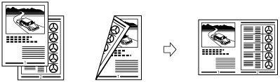

This mode enables you to output multiple scanned originals or two-sided originals arranged on one sheet of paper. You can select 2, 4, or 8 scanned originals to arrange on the page. You can also set two-sided copies and change the layout and order of images.
The originals are reduced automatically to fit the specified copy size.
2 On 1
This setting reduces two 1-sided originals or one 2-sided original to fit on one side of a sheet of paper.
4 On 1
This setting reduces four 1-sided originals or two 2-sided originals to fit on one side of a sheet of paper.
8 On 1
This setting reduces eight 1-sided originals or four 2-sided originals to fit on one side of a sheet of paper.

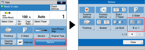

1.
Press [Copy].
2.
Press [Options] → [N on 1].
