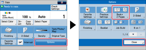

Place your original on the platen glass. The Book 2 Pages mode cannot be used when the original is placed in the feeder.
1.
Press [Copy].
2.
Press [Options] → [Book 2 Pages] → [Close].
