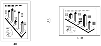

Automatically Specifying the Copy Ratio (Auto XY Ratio)
The XY copy ratio is automatically set to suit the size of the selected paper.

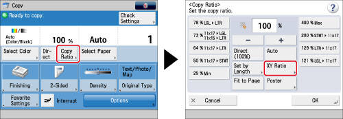

If LTRR is selected:
1.
Press [Copy].
2.
Press [Copy Ratio] → [XY Ratio].
3.
Press [X] and [Y] → press [-] or [+] to specify each copy ratio.
You can also use the numeric keys to enter values.

If you set the copy (zoom) ratio in [XY Ratio], the image of the original may be rotated before being printed. The machine calculates whether or not to do this based on the original size and the specified copy (zoom) ratio.
