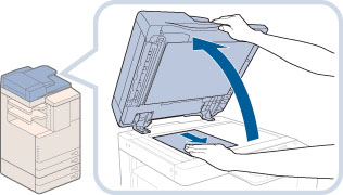

1.
Open the feeder cover.
* Sensor
IMPORTANT
This machine is equipped with an open/close sensor of the feeder cover (see circled area in the above illustration). When placing originals on the platen glass, lift the feeder cover approximately 11 7/8" (300 mm) so that the sensor detaches from the feeder cover. If the sensor does not detach from the feeder cover, the size of the originals may not be detected correctly.

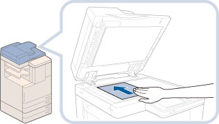

2.
Place your originals face down.
The surface of the original that you want to copy must be placed face down. Align the top edge of your original with the back edge of the platen glass (by the arrow in the top left corner).
Place books and other bound originals on the platen glass in the same way.
When you are enlarging an LTR or STMT original onto 11" x 17" or LGL paper, place the original horizontally on the platen glass, and align it with the LTRR or STMTR marks.

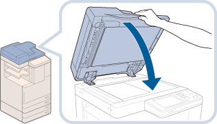

3.
Gently close the feeder cover.
CAUTION
Close the feeder cover gently to avoid catching your hands, as this may result in personal injury.
Do not press down hard on the feeder cover when using the platen glass to make copies of thick books. Doing so may damage the platen glass and result in personal injury.
Be aware that the light emitted from the platen glass may be very bright when closing the feeder cover.
IMPORTANT
If you are placing the original on the platen glass, the machine detects the size of the original after the feeder cover is closed. Be sure to close the feeder cover before copying.
