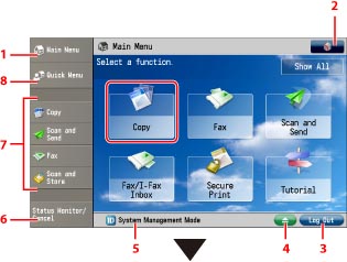

After the machine's power is turned ON, a screen similar to the following (the Main Menu screen) appears on the touch panel display. You can display the screens for each function from the function keys displayed on the Main Menu screen.
Main Menu Screen
Function Screen (Copy)
1.
Display the Main Menu screen. If the Main Menu screen is not displayed when using a function, it is necessary to press [Main Menu] before operating the machine. If you want to display all functions, press [Show All].
2.
You can specify the display settings for the Main Menu screen and the function screens.
3.
If you are logged in using a login service, [Log Out] is displayed.
4.
An icon indicating that a paper or staple jam has occurred, or an icon indicating that a USB device is attached, is displayed.
5.
The progress of jobs and copy operations, and the status of devices and consumables are displayed here. Also, depending on the login service you are using, the Department ID or user name can be displayed.
6.
Press to check the status of jobs or to cancel print jobs. Also, you can check the status of the machine such as the amount of paper remaining in the paper source. (See "Status Monitor/Cancel.")
7.
Presently stored function shortcut keys are displayed. (See "Setting Shortcut Buttons.")
8.
Press to display functions registered in the Quick Menu. (See "Quick Menu.")
