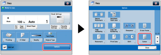

1.
Press [Copy].
2.
Press [Options] → [Gutter].
3.
Select the gutter position.
4.
Press [Front Side] or [Back Side] → press [-] or [+] to set their respective gutter width → press [OK].
