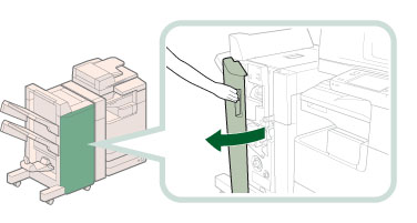

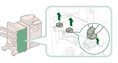

Open the front cover of the finisher.
2.

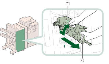

Pull out the saddle stitcher unit.
1. Grip the handle of the saddle stitcher unit, and pull out until it stops.
2. Pull the stapler unit of the saddle stitcher unit towards you, and then push it up.
*1 Stapler Unit of the Saddle Stitcher Unit
*2 Saddle Stitcher Unit
3.
Pull out the staple case containing the jammed staples, holding it by its left and right sides.
4.

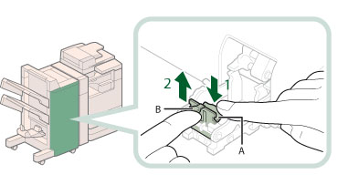

Push down the tab on the staple case.
1. Push down Part A to unlock.
2. Push up Part B.
5.

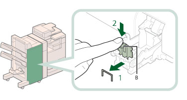

Remove any jammed staples.
1. Remove any jammed staples.
2. Return Part B to its original position.
6.

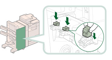

Return the staple case to its original position.
Push the staple case in until it clicks into place.
7.

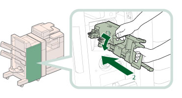

Gently push the saddle stitcher unit back into its original position.
1. Pull the stapler unit towards you, and then push it down into its original position.
2. Grip the handle of the saddle stitcher unit, and return it to its original position.
CAUTION
When returning the saddle stitcher unit to its original position, be careful not to get your fingers caught, as this may result in personal injury.
8.
Close the front cover of the finisher.
CAUTION
When closing the cover, be careful not to get your fingers caught, as this may result in personal injury.
