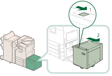

Move the paper deck unit away from the main unit.
1. Press the release button.
2. Move the paper deck unit away from the main unit.

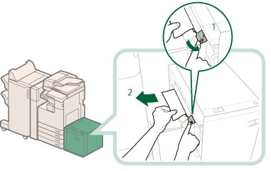

Remove any paper jammed in the side of the paper deck unit.
1. Hold down the green lever on the side of the paper deck unit.
2. Remove any jammed paper, while holding down the green lever.

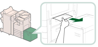

Paper can also be jammed in the feeding slot on the side of the main unit. Remove any jammed paper from the feeding slot.

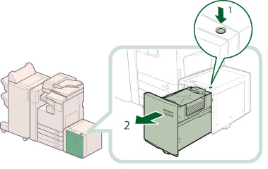

Open the paper deck unit.
1. Press the open button.
2. Open the paper deck unit.
The inside lifter automatically descends to the paper loading position.

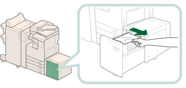

Remove any jammed paper.
Look carefully, as jammed paper may be difficult to see.
