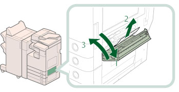

Remove any paper jammed in the paper drawer's upper right cover.
1. Open the paper drawer's upper right cover, holding it by its handle.
2. Remove any jammed paper.
3. Close the paper drawer's upper right cover.
CAUTION
When closing the cover, be careful not to get your fingers caught, as this may result in personal injury.
Gently close the cover until it clicks into place in the closed position.

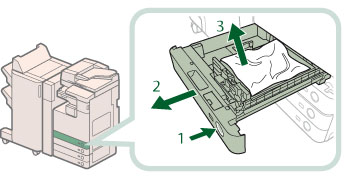

2.
Remove any paper jammed in the paper drawer.
1. Press the open button of the paper drawer.
2. Grip the handle, and pull out the paper drawer until it stops.
3. Remove any jammed paper.
3.
Gently push the paper drawer back into the machine until it clicks into place in the closed position.
CAUTION
When returning the paper drawer to its original position, be careful not to get your fingers caught, as this may result in personal injury.
If the Paper Deck Unit-B2 was moved away from the main unit, reconnect it to the main unit.
