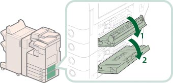

1.
Open the paper drawer's upper right cover and lower right cover.
1. Open the paper drawer's upper right cover.
2. Open the paper drawer's lower right cover.

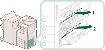

2.
Remove any paper jammed in the paper drawer's upper right cover and lower right cover.
1. Remove any paper jammed in the paper drawer's upper right cover.
2. Remove any paper jammed in the paper drawer's lower right cover.
