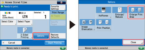

1.
Press [Access Stored Files] → [Memory Media].
2.
Select the desired memory media → select the location where the file you want to print is stored.
3.
Select the desired file → press [Print].
If you specify a PDF or XPS file, proceed to step 5.
4.
Select the paper source → press [OK].
5.
Press [Options] → [Enlarge Print Area] → [Close].
