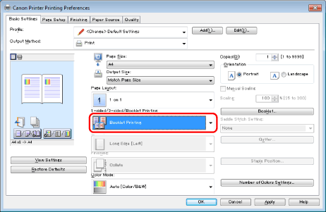

1.
Click [Basic Settings].
For instructions on how to display the printer driver screen, see "Printing" or "Configuring the Default Print Settings."
2.
Select [Booklet Printing] from [1-sided/2-sided/Booklet Printing].
If you want to saddle stitch (staple through the center of the pages) a printed booklet set, select [Saddle Stitch Setting].
You can also configure detailed settings such as the opening direction and gutter width for booklet printing in the [Detailed Settings for Booklet] dialog box, displayed by clicking [Booklet].
The output image is displayed in the preview area.
For details about the various settings in the [Detailed Settings for Booklet] dialog box, view Help (see "Viewing Help").
