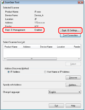

Start ScanGear Tool → select the scanner.
For details, see "Selecting the Scanner."
2.
Confirm that [Enabled] is displayed for [Dept. ID Management] → click [Dept. ID Settings].

4.
Click [Exit] in the ScanGear Tool.
