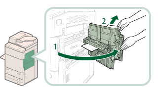

Check the location of the paper jam, and follow the procedure described below, and the procedure that appears on the touch panel display, to remove the jammed paper.
When the Paper Deck Unit-A1/Paper Deck Unit-D1 is attached, move the Paper Deck Unit-A1/Paper Deck Unit-D1 away from the main unit beforehand.
1.
Remove the paper that is not jammed from the multi-purpose tray.
1. Open the upper right cover.
2. Remove all of the paper that is not jammed from the multi-purpose tray.
2.
Remove any jammed paper from the upper right cover.
1. Remove any jammed paper.
2. Close the upper right cover.
