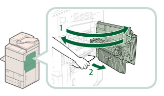

Remove any jammed paper from the upper right cover of the main unit.
1. Open the upper right cover.
2. Remove any jammed paper.
3. Close the upper right cover.
CAUTION
When closing the cover, be careful not to get your fingers caught, as this may result in personal injury.

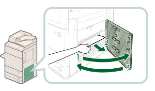

Remove any jammed paper from the lower right cover of the main unit.
1. Open the lower right cover.
3. Close the lower right cover.
CAUTION
