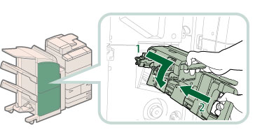

Pull out the saddle stitcher unit.
*1 Stapler Unit of the Saddle Stitcher Unit
*2 Saddle Stitcher Unit
1. Grip the handle of the saddle stitcher unit, and pull out until it stops.
2. Pull the stapler unit of the saddle stitcher unit towards you, and then push it up.

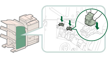

3.
Pull out the staple cartridge containing the jammed staples, holding it by its left and right sides.
4.
Push up the tab on the staple case.
1. Push down Part A to unlock.
2. Push up Part B.

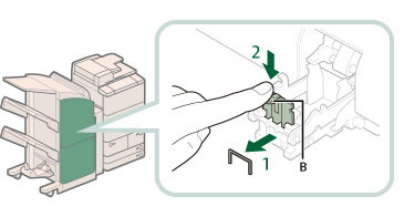

5.
Remove any jammed staples.
1. Remove any jammed staples.
2. Return Part B to its original position.

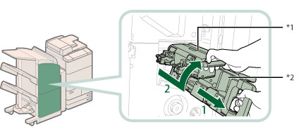

Gently push the saddle stitcher unit back into its original position.
1. Pull the stapler unit towards you, and then push it down into its original position.
2. Grip the handle of the saddle stitcher unit, and return it to its original position.
