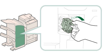

2.
Lift and pull out the staple case from the stapler unit, holding it by the green tab.

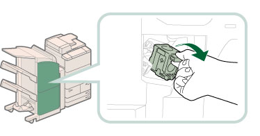

3.
Remove any staples jammed in the staple case.
1. Push down the tab on the staple case.
2. Remove all of the staples that slide from the staple cartridge.
3. Return the tab on the staple case to its original position.
4.
Gently push the staple case back into the finisher and push down firmly until it is securely in place.
