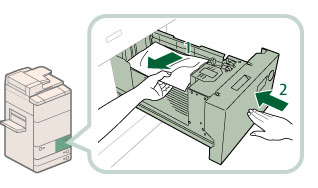

Check the location of the paper jam, and follow the procedure described below, while referring to the directions that appear on the touch panel display, to remove the jammed paper.
1.
Pull out the paper drawer.
1. Press the open button of the paper drawer that is feeding the paper.
2. Pull out the paper drawer until it stops.
If the paper drawer seems to be stuck, do not pull it out by force. Push it back into the machine, press the release button again, and then pull it back out.
2.
Remove any jammed paper, and push the paper drawer back into the machine.
1. Remove any jammed paper.
2. Gently push the paper drawer back into the machine until it clicks into place in the closed position.
CAUTION
When returning the paper drawer to its original position, be careful not to get your fingers caught, as this may result in personal injury.
3.
Follow the instructions on the screen.
The screen indicating the directions on how to clear the paper jam is displayed repeatedly until the paper jam is cleared.
