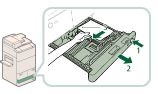

1.
Remove any paper jammed in the paper drawer.
1. Press the open button of the paper drawer that is feeding the paper.
2. Grip the handle, and pull out the paper drawer until it stops.
3. Remove any jammed paper.
2.
Gently push the paper drawer back into the machine until it clicks into place in the closed position.
