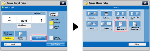

1.
Press [Access Stored Files] → [Advanced Box].
2.
Select the desired storage space → select the directory where the file you want to print is stored.
3.
Select the desired file → press [Print].
4.
Press [Options] → [Print Comments].
To change the paper source, see "Paper Selection."
5.
Press [Auto] → [OK] → [Close].
Comments specified within the PDF file are printed together with the file.
If you do not want to print the comments, press [Do Not Print].
