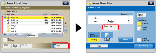

1.
Press [Access Stored Files] → [Advanced Box].
2.
Select the desired storage space → select the directory where the file you want to print is stored.
3.
Select the desired file → press [Print] → [Select Paper].
4.
Press the paper source → press [OK].

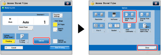

5.
Press [Options] → [Match Paper Size] → [Close].
