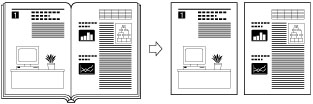

This mode enables you to scan facing pages in a book or bound original and record them onto separate pages.

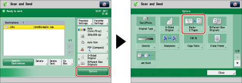

1.
Press [Scan and Send].
2.
Specify the destination → press [Options] → [Book2 Pages].
3.
Press [Close].
To scan multiple facing pages, turn the page of the original when scanning is complete → place your original on the platen glass → press (Start).
After the last batch of originals is scanned, press [Start Sending].
