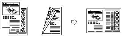

This mode enables you to scan multiple originals or two-sided originals and arrange them on one sheet of paper. You can select 2, 4, or 8 scanned originals to arrange on the page. You can also set two-sided printing and change the layout and order of images.
The originals are reduced automatically to fit the specified copy size.
2 on 1
This setting reduces two 1-sided originals or one 2-sided original to fit on one side of a sheet of paper.
4 on 1
This setting reduces four 1-sided originals or two 2-sided originals to fit on one side of a sheet of paper.
8 on 1
This setting reduces eight 1-sided originals or four 2-sided originals to fit on one side of a sheet of paper.

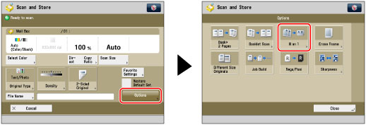

1.
Press [Scan and Store] → [Mail Box].
2.
Select the desired Mail Box → press [Scan].
3.
Press [Options] → [N on 1].
4.
Select the type of N on 1.
If you place a two-sided original, press [2-Sided Original] → select the type of two-sided original → press [OK].
