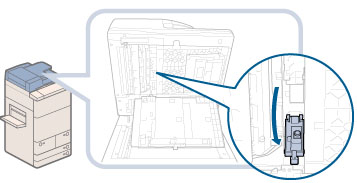

2.
Open the stamp cover.

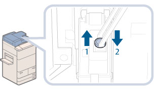

3.
Insert the stamp cartridge.
1.Remove the old stamp cartridge, using tweezers.
2.Push in the new stamp cartridge until it clicks.
IMPORTANT
Insert the stamp cartridge so that it is not slanted.
Insert the stamp cartridge properly, or paper jams may occur.
