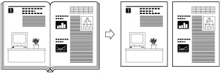

This mode enables you to scan facing pages in a book or bound original and record them onto separate pages.
