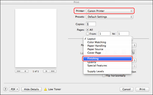

2.
Select the printer to use → select [Finishing].
The [Finishing] preferences panel is displayed.

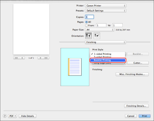

3.
Select [Booklet Printing] from [Print Style].
On the [Detailed Settings for Booklet] dialog box, displayed when [Booklet] is clicked, you can specify the detailed settings for the booklet, such as its layout.
