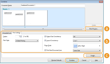

      7
      Change the settings as necessary, and click [Combine].
      The documents selected in step 6 are combined.
       [Print Preview]
      Displays a preview of the document to be printed.

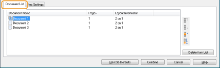

       [Document List]/[Print Settings]
      Click the [Document List] tab to display the documents added in steps 1 to 4. You can remove documents by selecting them in the list and clicking [Delete from List].
      Click the [Print Settings] tab to display the screen for specifying print settings such as the number of copies or 1-sided/2-sided printing. The settings specified here are applied to the whole print job.
      NOTE:
      For more information, click [Help] on the Canon PageComposer screen.
       [Details]
      Displays the print setting screen of the printer driver. There are fewer settings available than when using the ordinary printing method.
