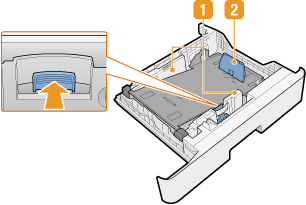

      Side paper guides
      Adjust the side paper guides to exactly the width of the loaded paper to ensure that paper is fed straight into the machine. Press the lock release lever that is marked with the arrow in the illustration to release the lock and slide the side paper guides.
      End paper guide
      Adjust the end paper guide to the length of the paper to load. Remove and replace it on the position that is suitable for the paper.
