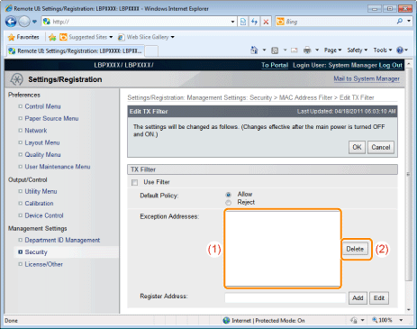

7

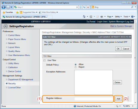

Set the MAC address.
(1)
Enter the MAC address of a device of which you want to permit to access.
Enter the address without placing a hyphen (-) between characters, like AABBCCDDEEFF.
(2)
Click [Add].
You can set up to 50 addresses.
When deleting a set MAC address
(1)
Select a MAC address you want to delete.
(2)
Click [Delete].

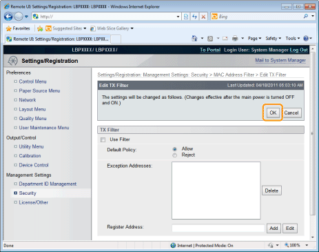

8
Click [OK].
9
Perform a hard reset or restart the printer.
After performing a hard reset or restarting the printer, the settings are effective.
