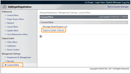

From the top page of the Remote UI, click [Settings/Registration] → [License/Other] → [Register/Update Software].
