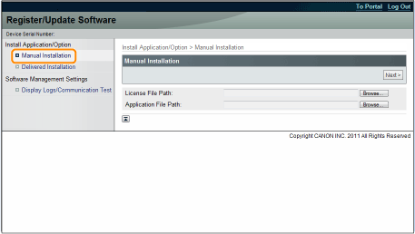

Click [Manual Installation].
4
Click [Browse...] → select the license file to install → click [Next].
4
Click [Browse...] → select the license file and the application file to install → click [Next].
