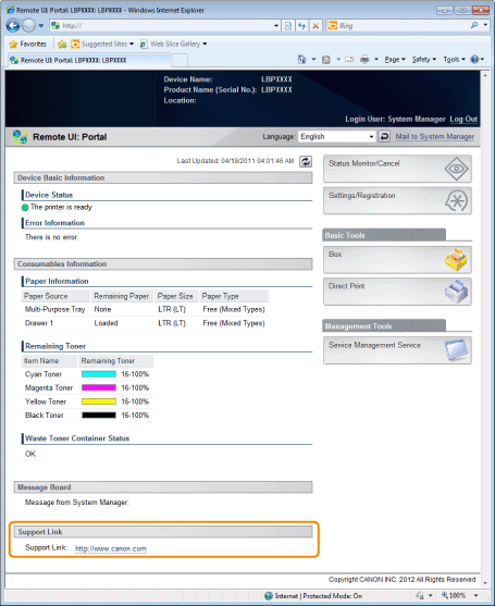

Displaying a Support Page
1
From [Support Link] on the portal page, click the link destination on the support page.

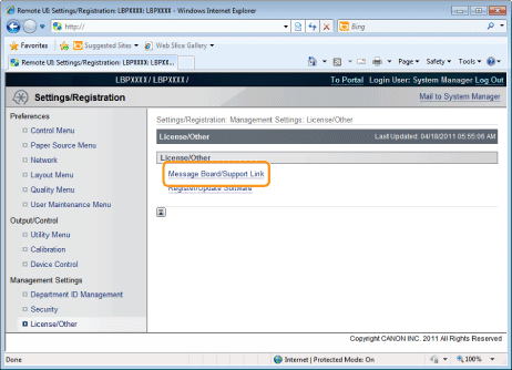

1
Select [Message Board/Support Link].
From the [Settings/Registration] menu, select [Message Board/Support Link] in [License/Other] under [Management Settings].

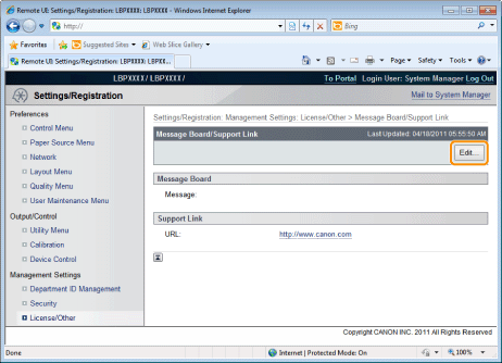

2
Click [Edit...].
 If [Edit...] does not appear
Log in as Administrator.

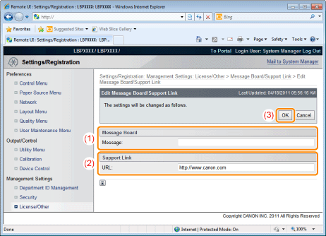

3
Change the message link destination.
(1)
Set message board messages when necessary.
(2)
Set support link URL when necessary.
(3)
Click [OK].
[Message]
Enter messages from the administrator.
[URL]
Enter the URL address of the support link.
The supported URL protocols are as follows.
http://
https://
If you omit the supported URL protocol in entering the URL address, it is interpolated automatically.
