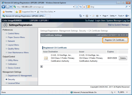

Click [Register CA Certificate...].

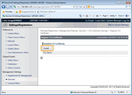

Click [Install...].

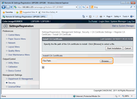

Specify the location of the CA certificate file.
Either select the CA certificate file by clicking [Browse...], or enter the location where CA certificate file is stored.

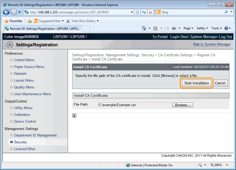

4
Click [Start Installation].
The CA file installation starts.
