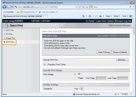

Start the Remote UI.
2
Select [XPS Files] from the [Direct Print] menu.
When department ID management is set, a dialog box for entering your user name and password is displayed. Enter the department ID for user name and PIN for password, and then click [OK].
3
Specify [Specify XPS File].
(1)
Click [Browse...], select the file, and then click [Open...].
(2)
Clear the [Prioritize Print Ticket] check box.
If the [Prioritize Print Ticket] check box is selected, some items cannot be set via the Remote UI. To use all the print settings made via the Remote UI, clear the [Prioritize Print Ticket] check box.

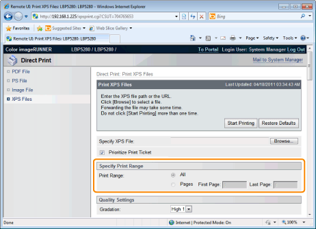

4
Specify the setting for [Specify Print Range].
[All]
Select if you want to print all the pages.
[Pages]
Select [Pages], and then enter the starting page number and ending page number if you want to specify the print range.

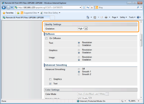

5
Specify the settings for [Quality Settings] as the following, as needed.
[Gradation]
Specify the gradation process for printing the data. It is effective to set [High 1] when printing photographs at standard quality, and to set [High 2] when printing at a higher quality.
6

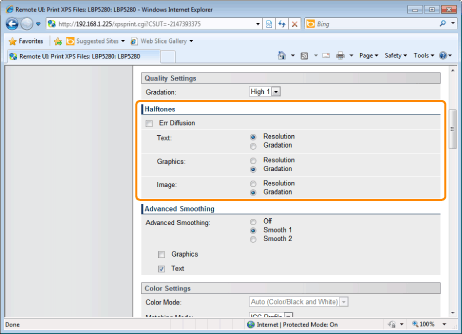

Specify the settings for [Halftones] as the following, as needed.
[Err Diffusion]
Specify the halftone display method when printing.
You can set it for these data types: [Text], [Graphics] or [Image].
[Resolution]
You can print in fine detail so that the edges of text data can be seen clearly. It is suitable for printing data containing text and fine lines.
[Gradation]
You can perform printing that combines smooth gradation with edge quality. It is suitable for printing graphics or graphs that use gradation.

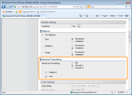

7
Specify the settings for [Advanced Smoothing] as the following, as needed.
Specify whether to use the smoothing process to smooth the edges of graphics (illustrations created in other applications) or text. [Smooth 2] is better than [Smooth 1] for performing a smoothing process that provides more smoothing. First, set it to [Smooth 1], and if the data is still not smooth, set it to [Smooth 2].
In addition, by selecting [Graphics] and [Text], you can select what to smooth.
This item specifies the smoothing process for graphics data and text data. Image data cannot be specified.
[Graphics] and [Text] settings on the printer console are suitable only when [Advanced Smoothing] on the printer driver is set to [Printer Default].
The effects of advanced smoothing differ depending on the pattern of the text or the graphics.

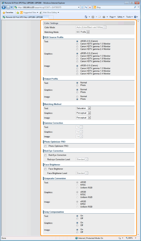

8
Specify the settings for [Color Settings] as the following, as needed.
[Color Mode]
Specify color printing or B&W printing.
[Auto (Color/Black and White)]:
It automatically switches between color and black and white printing depending on the type of document.
[Black and White]:
Even color documents are printed in black (Bk) only.
[Color]:
It prints in 4 colors: cyan (C), magenta (M), yellow (Y) and black (Bk).
[Matching Mode]
It sets which color matching method to apply for each piece of text, diagram or image that make up a print job, or for every color space such as RGB or CMYK. You can select whether to use methods such as ICC profile and gamma for processing. The items that can be set depend on the PDL type.
[ICC Profile]:
You can select a matching method, which is an adjustment method for bridging the difference in input and output color space width between the input profile that depends on the color space of the input data, and the output file that defines the device-dependent color space.
[Gamma]:
You can select a gamma correction value selection for adjusting the brightness in relation to the median color (color value with the maximum and minimum values taken away) of the entered data.
[RGB Source Profile]
You can select an RGB profile that is suitable for the features of the monitor that you are using. Set it when printing images drawn with an RGB color model or documents that contain images.
[sRGB v3.0 (Canon)]:
It can be set to general Windows computer monitor profiles defined by industry standards. When using monitors that support RGB, you can print colors close to the colors displayed on the monitor.
[Canon HDTV gamma 1.5 Monitor]:
[Canon HDTV gamma 1.8 Monitor]:
[Canon HDTV gamma 2.4 Monitor]:
You can adjust the gamma correction level of RGB data. The higher the value, the darker the printing.
[Output Profile]
You can define suitable profiles for data that you are trying to print.
[Normal]:
It matches with colors close to the colors displayed on the monitor, and prints.
[Photo]:
It matches with colors similar to photographs, and prints.
[Matching Method]
Specify the printing method when [RGB Source Profile] is applied. You can select color rendering style on the machine, as shown below.
[Perceptual]:
It provides colors suitable for printing photos and bitmap images.
[Saturation]:
It provides colors suitable for printing artwork and graphs for use in presentations.
[Colorimetric]:
It reproduces as accurately as possible the RGB color values that are within the machine's color gamut.
[Gamma Correction]
It adjusts the brightness of the printed result so that the brightest and darkest parts of the document are not lost. Set it when the print result is brighter than the original (such as a photograph prior to being scanned or a graphic created on a monitor) or when you want to change the brightness of the output. The larger the setting value, the darker it is printed. [1.4] shows no correction
[Photo Optimizer PRO]
Correct the contrast, color balance, saturation and gradation of photos and illustrations to your preference.
The setting for this item becomes invalid for B&W data.
If [Color Mode] is set as [Black and White], the setting for this item becomes invalid.
[Red-Eye Correction]
It detects and corrects red eye caused by flash or strobe light when shooting. Also, if only half of a face shows up in a photo, it can be corrected.
You can set the amount of [Red-eye Correction Level] correction.
[Weak]
The amount of correction can be set a little smaller.
[Standard]
The amount of correction can be set in the middle between weaker and stronger.
[Strong]
The amount of correction can be set a little larger.
[Face Brightener]
It can correct photographs in which people's faces are dark due to insufficient backlighting or underexposure so that the entire image is brightened and the people's faces are the preferred brightness.
It can only correct images which are at least 100 pixels both horizontally and vertically.
The face brightening effect may differ depending on the data.
You can set the amount of [Face Brightener Level] correction.
[Weak]
[Standard]
[Strong]
[Grayscale Conversion]
Select the method for converting color print data to grayscale for printing.
This setting is for converting color data to B&W data.
If [Color Mode] is set as [Auto (Color/Black and White)] and [Color], the setting for this item becomes invalid.
[sRGB]:
It calculates the grayscale value using the RGB standard color conversion method.
[NTSC]:
It calculates the grayscale value using the NTSC standard color conversion method.
[Uniform RGB]:
It takes the average value of the Red, Green and Blue color values as the grayscale value.
[Gray Compensation]
Specify whether to print grey data in Bk only.
When it is set to [On], black and grey data is printed in Bk only. You can prevent color registration errors.
When it is set to [Off], CMYK 4 color will also be used for black and gray data, and it will be printed in black and gray. The reproduction of dark color gradation will be better than when the check box is selected.

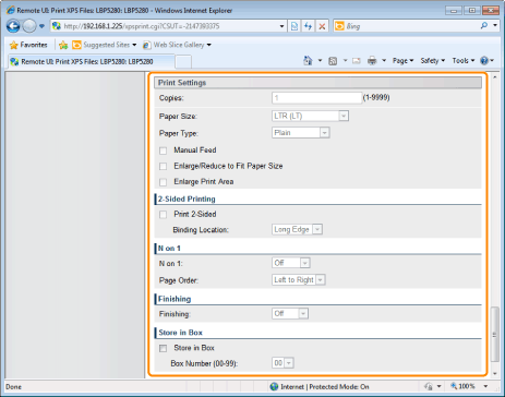

9
Specify the settings for [Print Settings] as the following, as needed.
[Copies]
Specify the number of copies to be printed.
[Paper Size]
Specify the size of paper to print.
If data is input that is outside the engine's maximum and minimum paper size range when the paper size is automatic, it is printed on the paper size that is set with [Standard Paper Size].
[Auto]:
It selects the most suitable paper source for the XPS file page size, and prints.
Other than [Auto]:
It prints so that the long side of the XPS file and the long side of the selected paper size go in the same direction.
[Paper Type]
Specify the type of paper to print.
[Manual Feed]
You can fix the paper source in the multi-purpose tray.
[Enlarge/Reduce to Fit Paper Size]
If the check box is selected, it fixes the aspect ratio and scales it to fit with the effective print area of the paper size that is set and prints. However if [Paper Size] is set as [Auto], this item cannot be set.
[Enlarge Print Area]
Specify whether to expand the printable area and print.
Depending on the document to be printed, part of the edges of the paper may not be printed.
[Print 2-Sided]
Specify 1-sided or 2-sided printing.
[Binding Location]
Set the binding position on the long side of the paper (long-edged binding) or the short side of the paper (short-edged binding). If binding is set from the printer side, the position of the "gutter" is automatically adjusted on the front and back sides of the paper.
[N on 1]
You can print multiple pages of the XPS file data arranged on one page.
When printing multiple pages side by side, set [Paper Size] to a setting other than [Auto].
[Page Order]
The [N on 1] setting enables you to set the order the pages will be arranged on the paper when printing multiple pages on one page.
[Finishing]
It collates and prints in page or section units.
[Off]:
Print the number of copies specified for every page.
[Collate]:
The specified number of copies are collated.
[Store in Box]
When storing it in a box, check the [Store in Box] check box before selecting the box where you want to store it.

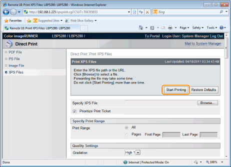

10
Click [Start Printing].
Do not keep clicking [Start Printing] while the file is transferring. Sometimes it takes time to transfer a file, but if you keep clicking during the transfer, a file failure may occur and it may be impossible to transfer it.
When the print job has finished sending, the display switches and the following message is displayed.
Press [To Job List] to check the print job that was sent.
