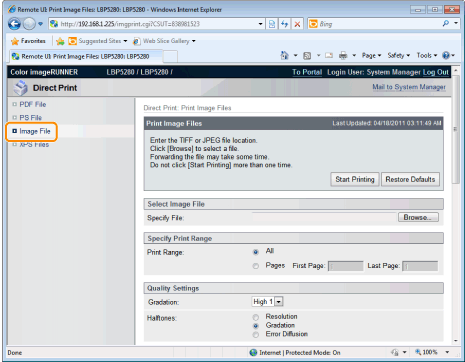

Start the Remote UI.
2
Select [Image File] from the [Direct Print] menu.
When department ID management is set, a dialog box for entering your user name and password is displayed. Enter the department ID for user name and PIN for password, and then click [OK].

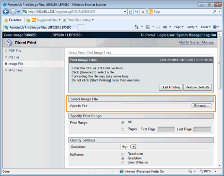

3
Specify [Select Image File].
Click [Browse...], select the file, and click [Open...].

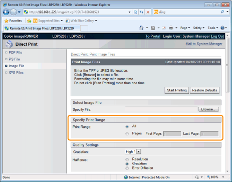

4
Specify the setting for [Specify Print Range].
[All]
Select if you want to print all the pages.
[Pages]
Select [Pages], and then enter the starting page number and ending page number if you want to specify the print range.

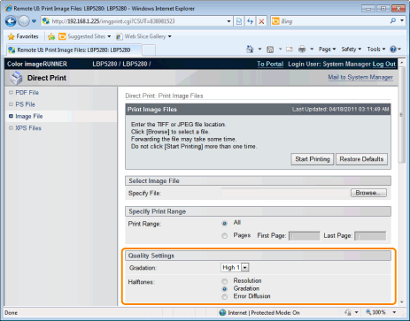

5
Specify the setting for [Quality Settings].
[Gradation]
Specify the gradation process for printing the data. It is effective to set [High 1] when printing photographs at standard quality, and to set [High 2] when printing at a higher quality.
[Halftones]
Specify the halftone display method when printing.
[Resolution]:
You can print in fine detail so that the edges of text data can be seen clearly. It is suitable for printing data containing text and fine lines.
[Gradation]:
You can perform printing that combines smooth gradation with edge quality. It is suitable for printing graphics or graphs that use gradation.
[Error Diffusion]:
It is possible to print at a higher resolution than [Resolution], but texture stability is slightly inferior. It is suitable for printing data containing text and fine lines and data such as CAD data that is printed with sharp edges.

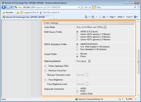

6
Specify the setting for [Color Settings].
[Color Mode]
Specify color printing or B&W printing.
[Auto (Color/Black and White)]:
It automatically switches between color and black and white printing depending on the type of document.
[Black and White]:
Even color documents are printed in black (Bk) only.
[RGB Source Profile]
You can set a simulation target when printing CMYK data. The machine converts CMYK data to a device-dependent CMYK color model in accordance with the simulation target selected by the CMYK simulation profile.
In order to enable this setting, set [CMS (Matching)/Gamma] as [CMS].
[sRGB v3.0 (Canon)]:
It can be set to general Windows computer monitor industry standard image quality. When using monitors that support sRGB, it can match the colors displayed on the monitor and the colors printed in the printer and print colors close to the colors displayed on the monitor.
[Canon HDTV gamma 1.5 Monitor]:
[Canon HDTV gamma 1.8 Monitor]:[Canon HDTV gamma 2.4 Monitor]:
It adjusts the brightness of the printed result so that the brightest and darkest parts of the data are not lost. Set it to adjust the brightness, such as when the print result is brighter than the colors displayed on the monitor. The larger the gamma value, the darker it is printed.
[CMYK Simulation Profile]
[JapanColor(Canon)]:
Use JapanColor profile. Use it for printing in colors that are close to Japanese printing standards.
[U.S. Web Coated v1.00 (Canon)]:
Use U.S. Web Coated profile. Use it for printing in colors that are close to U.S. printing standards.
[Euro Standard v1.00 (Canon)]:
Use the Euro Standard profile. Use it for printing in colors that are close to European printing standards.
[Output Profile]
You can define suitable profiles for data that you are trying to print.
[Normal]:
It matches with colors close to the colors displayed on the monitor, and prints.
[Photo]:
It matches with colors similar to photographs, and prints.
[Matching Method]
Specify the printing method when [RGB Source Profile] is applied. You can select color rendering style on the machine, as shown below.
[Perceptual]:
It provides colors suitable for printing photos and bitmap images.
[Saturation]:
It provides colors suitable for printing artwork and graphs for use in presentations.
[Colorimetric]:
It reproduces as accurately as possible the RGB color values that are within the machine's color gamut.
[Photo Optimizer PRO]
(It is only displayed when an SD card is used.)
Correct the contrast, color balance, saturation and gradation of photos and illustrations to your preference.
The setting for this item becomes invalid for B&W data.
If the [Color Mode] setting is set as [Black and White], the setting for this item becomes invalid.
[Red-Eye Correction]
It detects and corrects red eye caused by flash or strobe light when shooting. Also, if only half of a face shows up in a photo, it can be corrected.
You can set the amount of correction using the [Red-eye Correction Level].
[Weak]:
The amount of correction can be set a little smaller.
[Standard]:
The amount of correction can be set in the middle between weaker and stronger.
[Strong]:
The amount of correction can be set a little larger.
[Face Brightener]
It can correct photographs in which people's faces are dark due to insufficient backlighting or underexposure so that the entire image is brightened and the people's faces are the preferred brightness.
It can only correct images which are at least 100 pixels both horizontally and vertically.
If [Color Mode] is set as [Black and White], the setting for this item becomes invalid.
The face brightening effect may differ depending on the data.
You can set the amount of [Face Brightener Level] correction.
[Weak]:
[Standard]:
[Strong]:
[Grayscale Conversion]
Select the method for converting color print data to grayscale for printing.
This setting is for converting color data to B&W data.
If [Color Mode] is set as [Auto (Color/Black and White)], the setting for this item becomes invalid.
[sRGB]:
It calculates the grayscale value using the sRGB standard color conversion method.
[NTSC]:
It calculates the grayscale value using the NTSC standard color conversion method.
[Uniform RGB]:
It takes the average value of the Red, Green and Blue color values as the grayscale value.

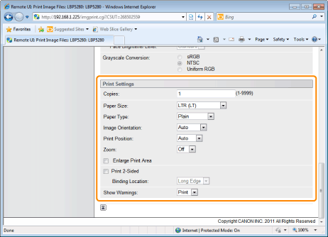

7
Specify the settings for [Print Settings] as the following, as needed.
[Copies]
Specify the number of copies to be printed.
[Paper Size]
Specify the size of paper to print.
[Paper Type]
Specify the type of paper to print.
[Image Orientation]
Select the orientation of the images from [Auto], [Vertical] or [Horizontal].
[Print Position]
Set the location of the images from [Auto], [Center] or [Top Left]. When [Auto] is selected, if the print location is specified in the TIFF format data, it will print at the specified location. If the print location is not set, it will print centered. Since print location is not specified in JPEG format, if [Auto] is selected, it will print centered.
[Zoom]
Specify whether to enlarge or reduce the printing. When it is set to [Auto], it automatically scales them to match with the effective print area of the paper and prints.
[Enlarge Print Area]
Specify whether to expand the printable area and print.
Depending on the document to be printed, part of the edges of the paper may not be printed.
[Print 2-Sided]
When it is set, it will print 2-sided.
[Binding Location]
Set the binding position on the long side of the paper (long-edged binding) or the short side of the paper (short-edged binding).
If binding is set from the printer side, the position of the "gutter" is automatically adjusted on the front and back sides of the paper.
[Show Warnings]
You can select a job processing method for when it detects an Imaging function error.
When it is set to [Print], the error description list is printed at the same time.
[Print]
The error description is printed on the paper and the job is terminated.
[Panel]
The error message is displayed on the printer's display, and printing stops.
[Off]
Even if an error occurs and nothing is displayed, the job is terminated.

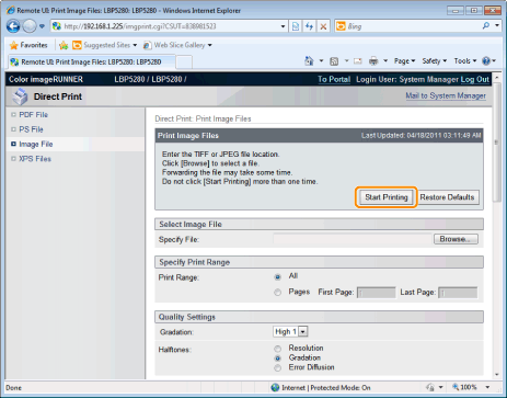

8
Click [Start Printing].
Do not keep clicking [Start Printing] while the file is transferring. Sometimes it takes time to transfer a file, but if you keep clicking during the transfer, a file failure may occur and it may be impossible to transfer it.
When the print job has finished sending, the display switches and the following message is displayed.
Press [To Job List] to check the print job that was sent.
