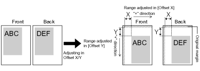

Perform [Offset Y] and [Offset X] using the control panel of the printer.
IMPORTANT
Confirm the adjustment result.
If any part of the print image lies outside the printable area after adjusting the printing position, the part will be missing in the print result.
Adjustable area
You can adjust the printing position between -1.97 and +1.97 in. for both the vertical direction and horizontal direction.

Select a position you want to correct.
If specifying the setting for [Offset Y]
1.
Select [Offset Y] using [  ] and [  ], and then press [OK].
2.
Specify the target numeric value using [  ] and [  ], and then press [OK].
Each time you press [ ], the setting value increases by 0.01 inch, and each time you press [  ], the setting value decreases by 0.01 inch. Also, if you keep pressing [  ] or [  ] without releasing your finger, you can keep increasing or decreasing the value.
The setting value is changed.
If specifying the setting for [Offset X]
1.
Select [Offset X] using [  ] and [  ], and then press [OK].
2.
