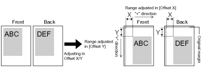

Adjustable area
You can adjust the printing position between -1.97 and +1.97 in. for both the vertical direction and horizontal direction.

Select a position you want to correct.
If specifying the setting for [Offset Y]
1.
Select [Offset Y] using [  ] and [  ], and then press [OK].
2.
Specify the target numeric value using [  ] and [  ], and then press [OK].
Each time you press [ ], the setting value increases by 0.01 inch, and each time you press [  ], the setting value decreases by 0.01 inch. Also, if you keep pressing [  ] or [  ] without releasing your finger, you can keep increasing or decreasing the value.
The setting value is changed.
If specifying the setting for [Offset X]
1.
Select [Offset X] using [  ] and [  ], and then press [OK].
2.
